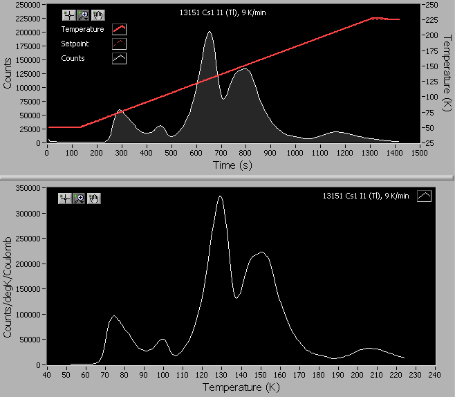

Attached is a recent test measurement of Thermoluminescence of CsI(Tl) scintillator, ramping from 50 to 225 K.  PID settings are the default of the unit (no Autotune or Zone settings, and no manual tuning of any kind).  The upper graph shows the ramp (where the temperature stayed reasonably close to setpoint) and counts versus time, while the lower graph shows counts per degree K increase of temperature.  The ramp in temperature is not perfectly linear, but the slight non-linearity should be unimportant once you convert to counts/degK.
I would advise doing some experiments with the Ramp function and see how it goes.  Only put in the effort of complex PID settings if needed.

@RSGR wrote:
 My experiment is also thermoluminescence so I wanted a linear variation in temperature.
BTW, it doesn't sound (from your first post) like your doing Thermoluminescence.  TL data is collected continuously as the temperature increases; your description is that you are "triggering a spectrograph" at specific temperatures.  Can your spectrograph not collect continuously?

Continuous is better, but you could use an instrument that takes snapshots if you measure the temperature ramp rate at the moment the snapshot is taken (divide counts/sec by degK/count and you have counts/degK).  But you should probably want to take spectrograph measurements as fast as it can handle, rather than picking 5 to 10 K increments.  Gives you the best data.   Your first described mode, of 'stabilizing' the temperature before measurement, is useless for Thermoluminescence.
Of your modes, try PI at first, with whatever the controllers default values are.
