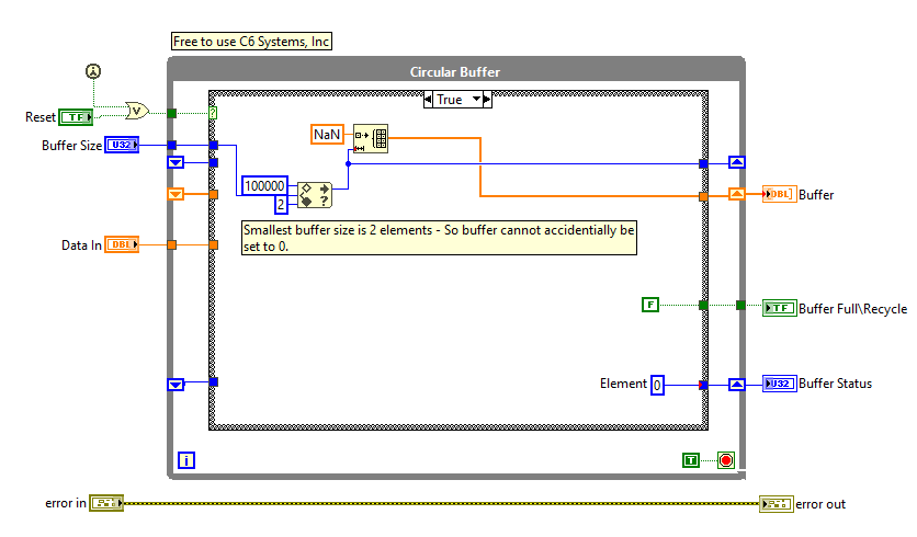

I've attached a circular data buffer which accumulates a single value into a USR. It pre-allocates memory in the 'Reset' mode and uses 'replace array subset' which is more efficient.
It features an 'init/reset' state where the buffer size is pre-allocated. Then a process state where the element is inserted into the buffer in sequence.
NOTE: The buffer using floats is initialized with Nan - so statistics and plotting don't occur for null values. But you can initialize the buffer as you wish - modify the code.Circular Buffer Init Diagram.png
