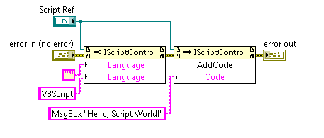

Actually, I'm trying to call a VBScript from ISriptControl wich is an ActiveX controll.
Message 3 of 13
(12,511 Views)
How about just using the Windows Scripting Host app, wscript.exe? You can just call this via the System Exec function that ships with LabVIEW. No ActiveX necessary.
Message 4 of 13
(12,499 Views)
By the way, are you seeing this bug? If so, just do what the article says, and write a null string to the "Language" property and then set it to "VBScript". For example, the following little bit works:

Does this still work in 2013? I get this error:
"Error 97 occurred
Possible reason(s):
LabVIEW:  A null or previously deleted refnum was passed in as an input."
Probing the refnum control provides "0" and the class selected is "MSScriptControl.IScriptControl"
Using: LabVIEW Version 11.0.1 (32-bit)
-labviewz

Maybe it to late but there is a code I used to execute a VB script

Where do you get the MSscriptControl and IScriptControl?
Message 9 of 13
(11,394 Views)
There is a couple of step to get the right automation Refnum:
Let me know if you need more explanation
