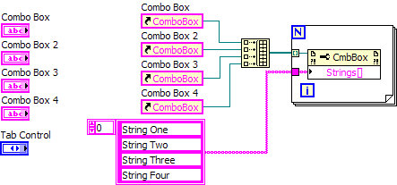

I rarely disagree with Ben, but an Action Engine seems to me like overkill for a task you want to do once when the application starts.  Just build a reference of all your comboboxes (shouldn't be too much work unless you have a huge number of them), then loop through the array, as shown:
I got the impression he wanted to do it several times, in which case your loop could simply be put in an AE.
If you're only doing it once there's really no need for a sub-vi, no. 🙂
