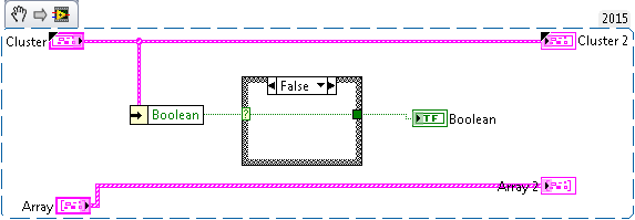

I started (and erased) this message differently because I misunderstood the discussion, but here is what I'm seeing with code coverage, and I realized an issue with "Diagram Disable Structure"
I'm actually trying UTF, and I'm particularly interested by code coverage, and I'm also facing some strange behaviors in results:
VI Test Snippet.pngWith this simple VI, I have a test, with 2 test cases, 1 with Boolean = True, and the second with Boolean = False.
Code coverage gives
Code Coverage.jpgWhere I expect 66,7 both times.

But the first case is not clear, because, i dont know how may reach on that vi 66% and 100% code coverage. So there is a case structure with TRUE and FALSE cases, and i would expect only 50% coverage is reachable within one test run.

Actually, UTF uses the number of subdiagrams as the percentage of coverage.
- There is always 1 diagram (principal)
- Then, each structure may have 1 or sevral diagram. For a case structure with only False/True, there is 2 subdiagrams.
So, in my example, there is 3 subdiagrams (Principal + case structure). And each test case runs 2 diagrams on 3 (the principal + 1 case of case structure) -> 66%

I'm not an expert on code coverage. What do you mean by "branch coverage" ?
UTF only regards the part of diagrams being executed during a test to realize a code coverage measurement.
What I called the principal diagram is the block diagram of you VI under test, there is no possiblity that this block diagram is not executed when your VI execute.
Then, depending on your code, and particularly on case structure where there can be several sub-diagrams (1 for each case), and depending on the combinatory of your complete code, there will be several "branches", and UTF will measure a percentage of subdiagrams executed as a result of code coverage, which may not fulfill with what you say "branch coverage" if I well understand.
In my example, there is only two branchs (as you pictured), but there is 3 diagrams. Thus, when you expect to have 50% branch coverage, UTF will return 66% code coverage.
