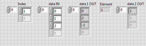

Hi community,
I am getting an unexpected output in data 2 OUT in the snippet below:
As you can see, data 2 OUT consists of a "2" but should consists of the "1" in Element.
Inserting an always copy dot into the wire leading to Element inside the inplace structure fixes the behaviour.

I don't think its related to the issue you mention, but what you are seeing is discussed here: https://forums.ni.com/t5/LabVIEW/Wire-value-changes-on-output-tunnel/td-p/3929090
There is a CAR number issued in the thread.
