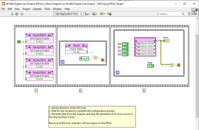

It takes some time for the module to get ready for output. You can refer to the shipping example <LabVIEW>\examples\CompactRIO\Module Specific\NI 9402\NI 9402 Digital Line Output\NI 9402 Digital Line Output (FPGA).vi
and monitor the ready before writing value.

Hi ZYong,
Thank you for your reply!
I am not configuring the channels in the FPGA code as shown in this example. Do you think that it is the same case for my code? Also, does it take 1 iteration to initialize and then execute in the next iteration? It seems like the digital output in my case becomes high every time in the next iteration than the one in which they are commanded to be so.
