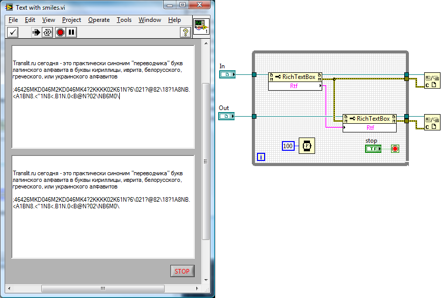

I tried to make a little test programm, which copies from one RTF to an other. The first problem  have is:
if I copy russian text from clipboard, than it will be shown right in both RTBs, but if I type this from keyboard, than I see anything wrong.
Any ideas?
Thanks, Eugen
