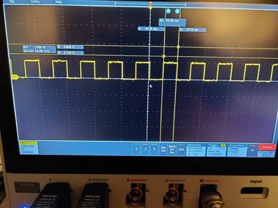

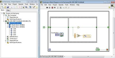

Hi, I'm wondering why I can not control an AO faster than 100Hz in cRIO Real time?
Hardware: cRIO-9067, Module NI9263 (100 kS / s / ch)
See pictures.
I would need to be able to control AO at 1kHz without the FPGA.
Does anyone have an idea.
20ms
10ms
9ms
7ms
6ms
5ms

Hi Niklas,
Because you are using the ScanEngine - with all its limitations!
Use the FPGA to get precise timings, especially at 1kHz and higher…
