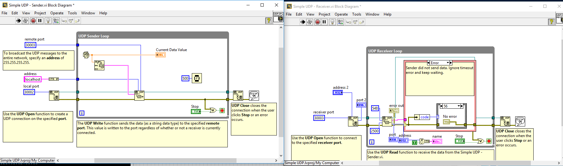

Did the Simple UDP project work before the changes you've made?  That'll make it easier to troubleshoot what's going on with it.  If you can use the example without modifications, try changing the ports.  If that still works, check the logic.
If anything doesn't work at any step, you know what to look at.  (if the first port works but the second doesn't, you're looking at a firewall issue related to the specific port for example)

This definitely should work just fine. (Many years ago I wrote a program to receive syslog messages)
Is this the only active network interface? Maybe you should try to wire the net address after all to see if you get an error if you specify the 192.168.100.1?

On local PC ports work just fine. I can read dataWrite and read_local PC.PNG

It end up to be firewall issue.
I found out that our IT guys would reset firewall settings if firewall was turn off complitly.
