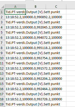

When im using a case structure only the last value gets saved to the 'logging' file. How do i get continuous logging?
Message 9 of 18
(4,062 Views)
Now this happened when trying to save as .csv
Message 10 of 18
