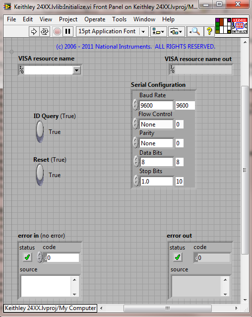

Trying to interface Keithley 2400 Sourcemeter using RS 232.
When I use the basic serial read and write vi, I get a "Keithley I*" at visa read, and I also get the following data -
bytes read - 83
string read - KEITHLEY\sINSTRUMENTS\sINC.,MODEL\s2400,1092330,C27\s\s\sFeb\s\s4\s2004\s14:58:04/A02\s\s/K/J\r\n
I get this when the string to write is - "*IDN?\n"
all the parameter match with that of the device (baud rate, parity, data bits, flow control)
Also can anyone tell me what is the Stop Bit and what value do I need to set it to be able to read data from Keithley.
I am new to LabView so please keep it simple and explain in detail. Thanks in advance.

The same driver you can use for RS232 interface as well.
See below, Init.vi in same library.
