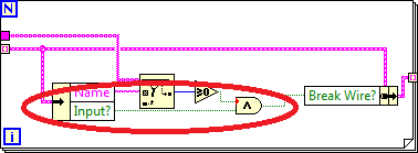

Did you try the fix I listed in the previous post?  Let's see if I can post code now, if it works simply replace GetTerms3.vi with the attached VI.
Did not work.  Let's try a screenshot.  Go into GetTerms3.vi and make the following change:

Thanks. Now, It works in 2012 too.
