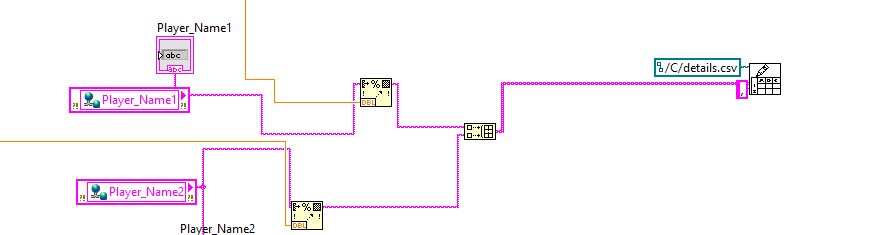

Trouble with Writing to spreadsheet file
Hi there, I encountered some problem while trying to write to a spreadsheet file. But when I tried to open the file, nothing was written there. Would appreciate your help,thanks.Untitled.png

Share Actual Vi/Snippet instead of Image.
 Did you got any error?
Are you sure data is being generated before writing to a file (can probe and check)

Hi, sorry about that. Here's the VI.

To be sure that you are writing some data to file, check by keeping an indicator/probe to the array input.
- Also make sure the file path is correct and you have read/write permission to that file.

I checked piece of your code by feeding inputs of my own, it works fine.
Make sure about your data, whether any data is being transfered to input node of Spreadsheet VI.

Now that I tried creating a new file in a new location and there's this pop-out. However, I'm sure that I've saved it to the correct location.

As suggested in error description just copy the file path and paste in file explorer or in run command and check if the file path is correct.
-One more easier method is right click on path constant browse for path and point to file.

You dont need to create a file, Write to spreadsheet file will create new file by default, if the file is not present

where exactly do you have your VI running? Which target system do you use?
Is it by any chance a RT target (like cRIO, myRIO)? You know those are "stand alone" computers on their own with NO access to your PCs harddrive?

Hi PalanivelT, I've tried all the suggestions, everything seems fine, but, still not able to read into spreadsheet file. I've also tried changing my input data to random number, still nothing is write in.
