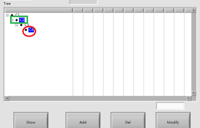

When the drag is not end yet, have any ways to get  c4 path?

My question want to know have any way, that get C4 path at dragging?

Your way can get "C4" path on dragging,but no way to get "C4" dragging on C2 at not drag end.
Have any way to get path that dragging on "C4" on "C2" at not drag end,get result like red circle?
