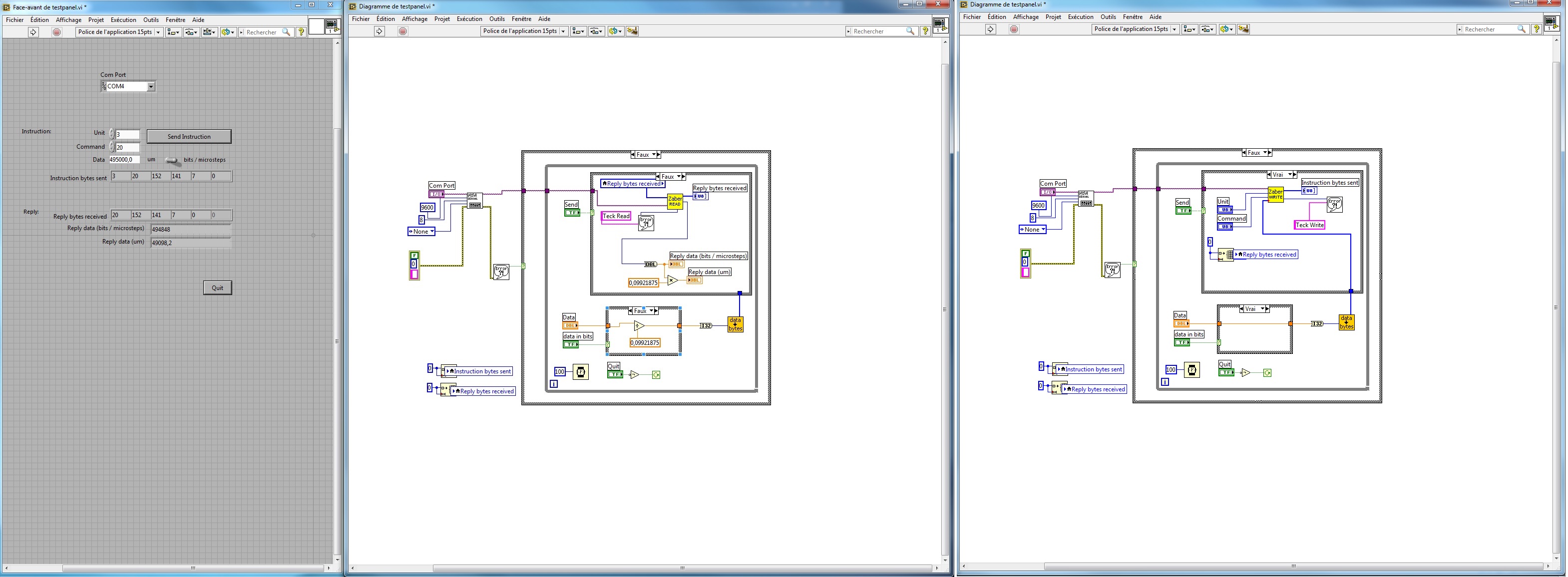

I have found this while looking through some files:
I have a few questions:
First, there is 6 bits sent, 6 received. There are units and command, what are the others? It is probably obvious but I don't see it.
Then I'd like to adapt a little bit this very functionnal panel, to make it a bit user friendly. Is it technically possible, without starting from scratch, to add some buttons, for instance:
- A global home button
- A +/- button for each unit. For example, if I have 3 units, there will be 3 +/-, and each clic would add let's say 100 microsteps
- A all-time indicators of  the position of the 3 units, no matter what was the last command?

If you want to know what other command options there are, you have to read the manual for the device. You haven't provided the make and model so how can anyone here help? You haven't even provided the actual code and a lot is hidden in subVIs.
From the image, it looks like you found an extremely old VI. It would really benefit from a rewrite using features introduced since LabVIEW 5.x such as the event structure. Since you are looking at major changes to add new features and the existing program does not seem to do much at all, the rewrite time would not be significant.

I apologize! Indeed a lot of info are missing, I realized it after.. Sorry again!
The unit I am using are linear actuator from Zaber company, and this is the model
http://www.zaber.com/wiki/Manuals/T-NA
And I added the whole code
Message 3 of 9
(4,543 Views)
The basic command, I mean the one I'll use most, are home (the actuator go back to its zero), move absolute, move relative, this kind of things.
The code as it is now works fine, I just would like to make it more user friendly, and convenient

A few suggestions:
I would suggest looking at having an event structure to respond to buttons. You can create buttons for the different commands and translate that into the correct command to send to the device. Take a look at some of the event examples in the LabVIEW example finder / templates for some inspiration (Producer/Consumer with Events). Your event structure responds to button presses and sends commands to the consumer loop which does the communications with the device.
In reality, once you have the protocol working for talking to/from the device, you probably don't care about the instruction bytes sent/received - you're probably only interested in the reply data in engineering units.
Maybe you would want to put some sort of slide to allow you to select the position from the full range of the device?

Thank you Sam for your suggestions 🙂 I'll take a lot at the examples and will try to improve my system
Oh a slide could be neat, good idea!
