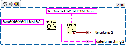

I'm having trouble getting ms resolution of seconds into the timestamp.
This gives me tenths of seconds. How can I get down to ms?
(I tried "%3u" [error] and "%.3u" [no change] on the format string for Scan from String.)

Hi Stevem,
%3u did not give error for me. check with the attached vi.

You are right Gogineni, when I got the error, I was using %S in the format string for Format Date/Time String function and %3u in the format string for Scan From String.
I found the solution in this thread - use %S%3u in both places.
