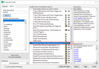

I want to use IMAQ to capture images from a USB camera. When I use 64-bit LabVIEW, I need to use IMAQdx session to create a new Session for IMAQ Grap. However, when using an IMAQdx session on the front panel of 64-bit LabVIEW, LabVIEW crashes immediately. I have tried multiple versions of LabVIEW. This problem does not occur on 32-bit LabVIEW.

This issue also occurs at the example code "Acquire Every Image (Optimized Performance).vi".
