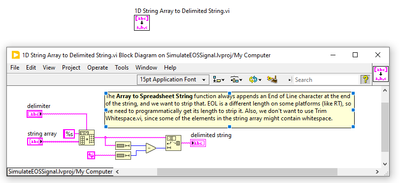

first of all: I am completely new to labview. I am trying to get my program to save measured values in a *.txt file in the following format:
TIMESTAMP SIGNAL1 SIGNAL2 SIGNAL3
I got as far as concatenating the timestamps and the signal1, but when I now add a second signal, the values are not delimited from each other. For example, I now get an output file like this:
13.12.2021 10:49:32,324    0,4325460,867425
I would like to have it in the following format:
13.12.2021 10:49:32,324    0,432546     0,867425
I attached a picture of what my code currently looks like

Hello Jay,
thank you for your answer. Using a space instead of a tab doesnt solve my problem. Now the output file reads as follows:
13.12.2021 13:34:18,8486 0,03436811,112798
I need the last two columns to be seperated like this:
13.12.2021 13:34:18,8486 0,0343681 1,112798
(1,228 Views)

Hi siebo92,
What is your "Build Table" subVI? It looks like Express VI with a blue background, but I couldn't find one in my LabVIEW (2020 SP1, 2021)?
for your question, "1D String Array to Delimited String" should do the job
https://labviewwiki.org/wiki/1D_String_Array_to_Delimited_String_function
