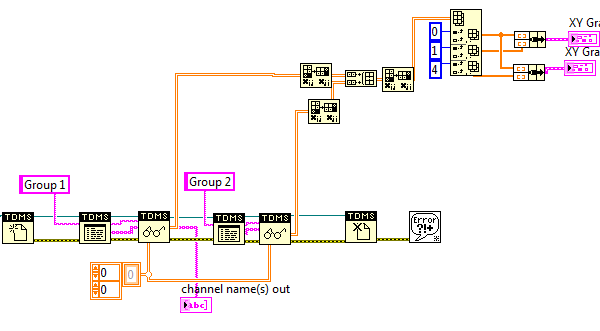

I can make it work by recording in two separate GROUPS.
If I read the two groups and then concat them, I get what I want:
But I have to do a lot of juggling:
And there are assumptions in that code that won't work for other cases. (If I delete channel B and substitute channel E, it will concat B & E).

I suppose you could start a new group everytime something changed in the channel count.  Since the juggling on the back end is the same for each group, a FOR loop could handle the repetition.
Give it an array of group names to read and turn it loose?
Message 7 of 17
(4,385 Views)
Well, yes. That's not too much different from having a separate file when something changes.
I don't see how to look at the whole file in that case though.
I have to do the transposing and re-transposing myself, though performance on the READ side is not critical.
See above.  But there are cases that won't handle: If I delete channel B and substitute channel E, then the data should NOT be concatenated, but it will be.
If I force the user to look at one segment at a time, it'll be OK.  But as far as using the Technical Data Management System for actually Managing my Data, it's leaving an awful lot up to me.
