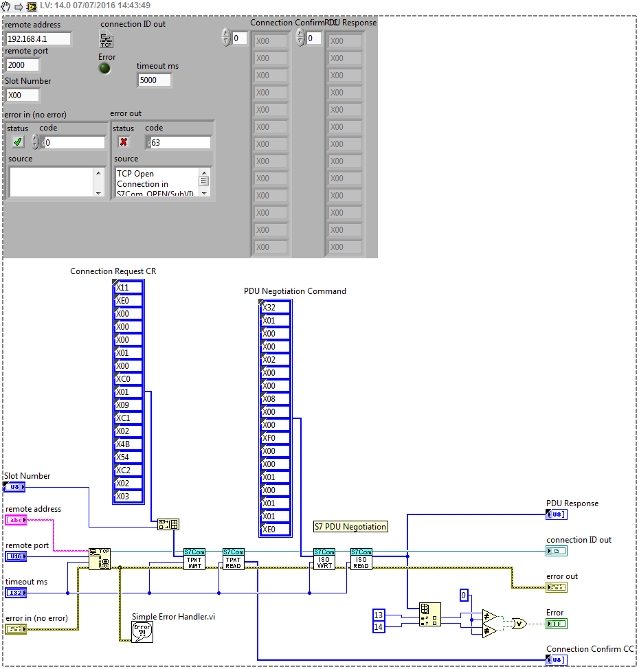

We try to develop a client driver (for PXI RT OS) in LabVIEW using TCP/IP in order to read data (later also send back some) from a Siemens S7 PLC. We do not wanna use the OPC approach.
I try to use some example codes from the link https://forums.ni.com/t5/Example-Code/S7-PLC-TCP-IP-Protocol-Reference-Example/ta-p/3492191 . The problem is that, I always get a "The network connection was refused by the server", code 63. (see 1st snapshot below). So I cannot test any Read/Write functionality since the simple "TCP Open Connection" command is already failing. The IP of the Siemens server is 192.168.4.1, and the PC is set to 192.168.4.2 fixed. The port number for the S7 is set to 2000, and also enabled in the Windows firewall.
As a counter-check, I succesfully connected to S7 using LabVIEW example from here (see the second snapshot below):
http://snap7.sourceforge.net/
The only problem with this LV driver set it uses a DLL, and I need to use simple TCP/IP functions since I wanna access the S7 system from a Real-Time OS, so no go for the DLL approach...
How it can be that the Snap7 example code works using TCP/IP, but a very simple connection attempt from LabVIEW by the "TCP Open Connection" fails??
Maybe someone could give me a hint or idea what else to try, or what I am doing wrong...?

I made some progress, it looks like the port number was actually not 2000 at the S7 side, I tried port number 102 (found info as it is the default value somewhere), and now at least no error after the TCP Open Connection! 🙂 I go on and try to make more progress with the given examples...
