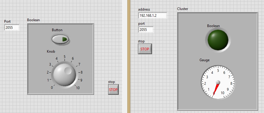

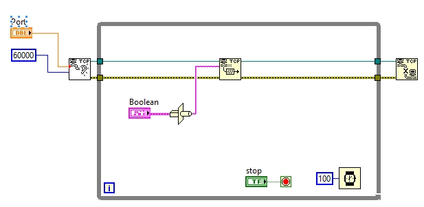

Hi everybody,
I'm studying about TCP / IP and make an example but it is not yet operational. Therefore I'm looking forward to receiving the help.
Fig.1: Server

What is the problem you are facing? Establishing the communication or recieving the data and formatting it back?

Copy the server Boolean cluster and paste it in the client where you are passing the "string constant". Also don't define the size of 2 bytes, you may endup missing data. From the server first send the size of the data to the client and then send the actual data.

It's clear that you looked at the shipping examples but it's also clear that you did not understand them. The whole purpose of reading two bytes and using that got the next read is that the example is pretending (with 2 bytes), the size of the data being sent. Your server does not do that so your read will fail.
It also does not make any sense to create a cluster with four elements. The cluster you have only had two elements. Focus on fixing the server.
