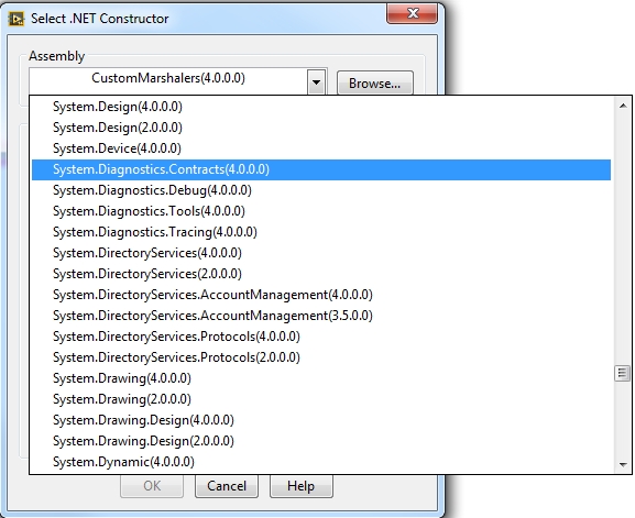

Searching online it appears the .net class is System.Diagnostics.Process.Start, but that's not available in the class browser in LabVIEW, and none of the System Diagnostics objects contain public classes. Do you still have your code to check which class you used? Cheers Duncan
.Net Constructor

Yeah, it's a bit confusing. It's actually in System and then System.Diagnostics:

Thank you for that Sam. That's what I needed to be able to call an exe using .Net, but that too uses the UAC prompt as the thread to wait for. .Net is more useful that SystemExec, so I'll look at what other methods & properties are available in there & post something on here once I've resolved it.
