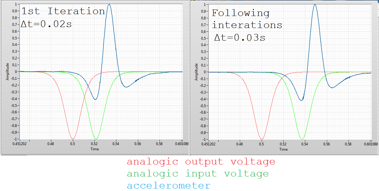

Hi HeinzG
Thank you for your answer. Unfortunately I tried your method but when I add the delay, the delay between output and input curves increases.
I also notice something strange to me. At the first iteration in the “for loop” over time, the delay is 0.02s then becomes 0.03s after the second iteration and remains constant (see image). If this can help to understand things….
Best,
Florian
