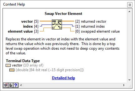

Playing with Scripting VIs I have found this Swap Vector Element node:
Swap Vector Element
I wonder, how safe and stable it is and why it's not included in all LabVIEW releases along with other array functions?.. It may be useful sometimes because it returns old element value which is replaced by new one. Replace Array Subset is not able to do that.

Open an example Adding Objects.vi, located at C:\Program Files (x86)\National Instruments\LabVIEW 2013\examples\Application Control\VI Scripting\Creating Objects, change Ring constant "Subtract" to "Swap Vector Element" and execute the VI. Or you can look at the attached file. I believe it's not matter which LV version I have. This instrument exists on any version starting with 8.0.

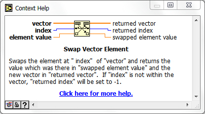

To be completely correct, this VI is presented in LabVIEW beginning with 7.0 version. Its description slightly differs from the one of new LVs:
Swap Vector Element (7.0)
I cannot find any signs of instability, but still ain't sure if it might be used in my own projects.

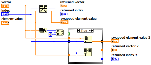

As it checks for array boundaries too, exact replacement for this VI should be the following:
And I don't see any reasons for using that mysterious VI, because the speed of its execution is nearly the same as the combination Index Array + Replace Array Subset has (tested this on large arrays being indexed and swapped in the loop). Whatever that "top level swap operation" means, there are no real advantages.
