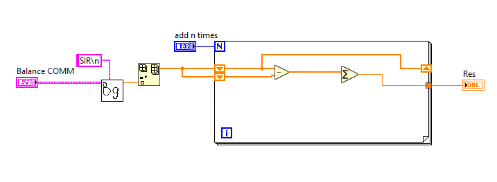

Hello everyone,
I have a device which generates a series of numbers at sampling times, let's say every 1s.
The series of numbers is denoted as x0, x1, x2, ..., xk. I want to get the result at each sampling time Res = xk - x(k-n). If n=4, that is Res4 = x4 - x0, Res5 = x5 - x1....For the first 4 numbers, Res3 = x3 - x0, Res2 = x2 - x0, and Res1 = x1 - x0.
My codeing idea is that
Res1 = (x1 - x0) +       0     + 0 + 0;
Res2 = (x2 - x1) + (x1 - x0) +0 + 0;
Res3 = (x3 - x2) + (x2 - x1) + (x1 - x0) + 0;
Res4 = (x4 - x3) + (x3 - x2) + (x2 - x1) + (x1 - x0);
Res5 = (x5 - x4) + (x4 - x3) + (x3 - x2) + (x2 - x1);
Because n is supposed to be a variable, I can not use shifters directly. I try to use the for loop with the loop count N being variable n. The attached file is a test vi.
Can you help me please? Thank you.

having not looking at your code.....
  • put the series of numbers into an array
  • feed into a for loop
  • numbers go into a double pulled down shift register
  • take the difference
  • feed that number to another shift register with the addition function
  • oputput of that shift register will give you the last value
note: manipulate the array to start at the first or last element, also feed the n# to the for loop to run

Why use loops and shift registers?
All you need to do is collecting your samples in an array…
(4,109 Views)
The array is aquired online instead of a given array. And the sum of difference is not calculated by all elements, it is calculated by the latest n elements. At each sample time, I get one result. I am still working on it. Thank you.

Is this what do you mean? (Bg is a subvi to obtain data from device at sampling times). Thank you.
(4,080 Views)
Accepted by topic author chalkwu
Hi chalkwu,
why do you put the whole array into the shift registers?
(4,065 Views)
Hi Knight. GerdW,
I thought there should have some subvi with the function storing certain length of some squence data. And that is Data Queue. Thank you very much.
