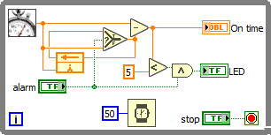

See if this can give you some ideas....
Message 16 of 27
