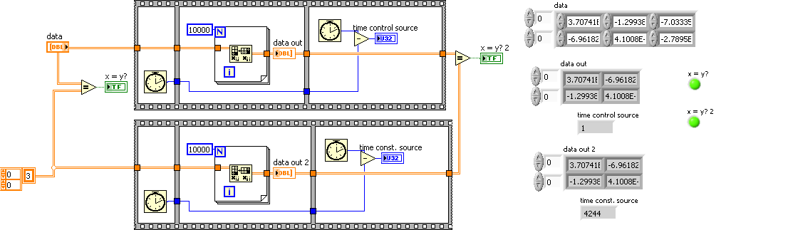

I was testing the efficiency of the transpose function in Labview so I did a simple test setup starting with by using a constant as source. At some time I changed the constant to a control, and the processing time dropped from about 4200 msec to a number between 1 and 2 msecI could reproduce the result at every runWhy is it like this?
I include my test VI in 8.0

Hi CoqRouge,
you found one of LabView's memory handling optimization mysteries Smiley Wink
I changed the attachment to disable parallelism as much as possible and changed to use ShiftRegisters instead of tunnels. Now both cases are same in speed (more or less).
My guess: LV is optimized for handling data from controls. You have wired a constant and LabView has to copy it's data over and over again, hence the speed penalty. Just a wild guess...

In my first test I did not have any parallelism, but changed the source from control to constant by right clicking on the source. But I get the same results regarding timing. Anyway, perhaps this demonstrate that in some cases a control with with default values is better than a constant. Or that a shift register is better if "Disable Indexing" is enabled on a loop output.

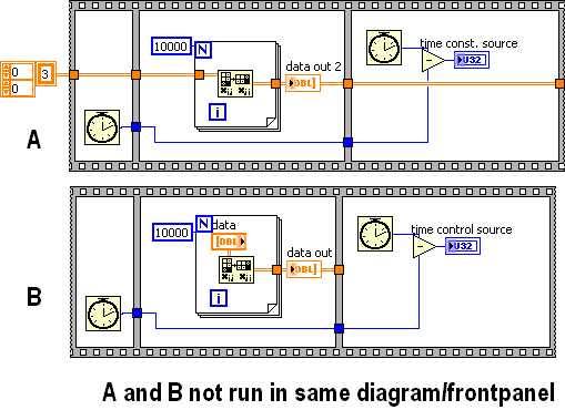

Then I was testing as shown in the figure below, the time was about equal and around 4200 msec

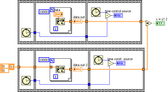

Then I tested like this in the same diagram the run time was about equal but the time jumped up to approximately 7800 msec

I Guess this explain my first question. Then using a constant the data is read in every iteration even if it is placed outside the loop. Perhaps this is a flaw, and a correction is needed?

There is something else going on here. The Transpose Array does actually not always physically copy data around. Instead it creates something called a subarray. This subarray is a special internal datatype in LabVIEW that contains not the real data but just a pointer the the original data. In addition to that it contains extra information such as the order of dimensions, the size of each dimension and even the direction of indexing. How it does this exactly is beyond my knowledge but basically when you do transpose an array what LabVIEW does is creating a subarray that contains the information that the dimensions are actually swapped to what they are normally expected.
Many array functions including the one that displays the data on a front panel for instance do know how to treat subarrays properly and also how to treat one, more or all special cases of such subarrays. If a particular function operating on a subarray does not know how to do its work on that particular type a conversion routine will create the real array out of that subroutine anyhow to let it be processed by that function.
Your original difference was most probably due to the fact that LabVIEW stores constants in a diagram differently than runtime data. A constant is stored with the VI to disk and loaded together with the VI into memory but marked read only, since it is a constant. Apparently the Transpose VI optimization decided for some reasons that the subarray approach will not work for constant data, so a new and realy transposed memory area gets allocated by it. This causes the time delay you see. For the case where the data comes from a control the buffer is not constant and Transpose Array simply produces a subarray and the only real runtime overhead is in displaying the data on the front panel.
No it is not a flaw. It is a decision about producing always the right result or being optimised and produce sometimes a wrong result. LabVIEW memory optimization is probably one of the most hairy areas in LabVIEW and there have been issues in the past where some dev went in to make a great optimization only to find out after the release that this did actually produce wrong results under some complicated situations.
