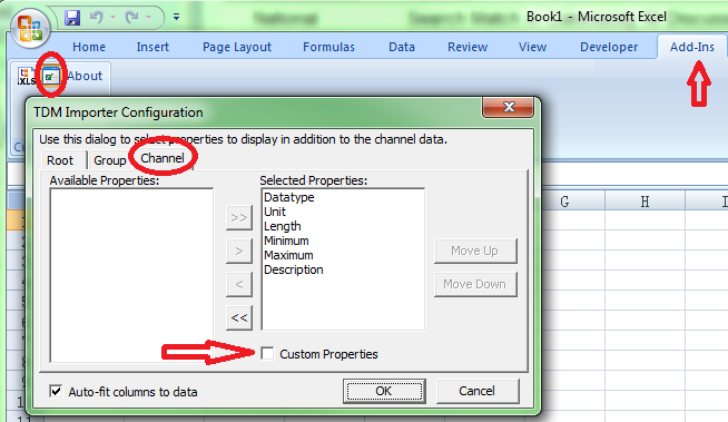

Hi guys. I'm trying to learn how to create a Report in labview.
I'm focusing on this VI patterns.
My idea is to create 8-9 channel group and for each channel show the information that I want.
The question I want to ask is if It is possible create a multiple channel group with only 1 VI pattern (I mean... placing the Write Data Channel Group in a For cicle)

another question:
if you open the exel you will see wf_increment, wf_samples, wf_start_offset etc etc where can I remove them?

Did you mean to open the tdms file in Excel with the TDM Excel Addin?
To remove the wf properties, you can uncheck the "custom properties" option for channel in the Addin configuration dialog. This way, you won't see other custom properties either.

yep the idea is to open it in Exel.
could you tell me better where I can find these custom properties? because I haven't seen them.

Sorry I forgot to attach the screenshot...
