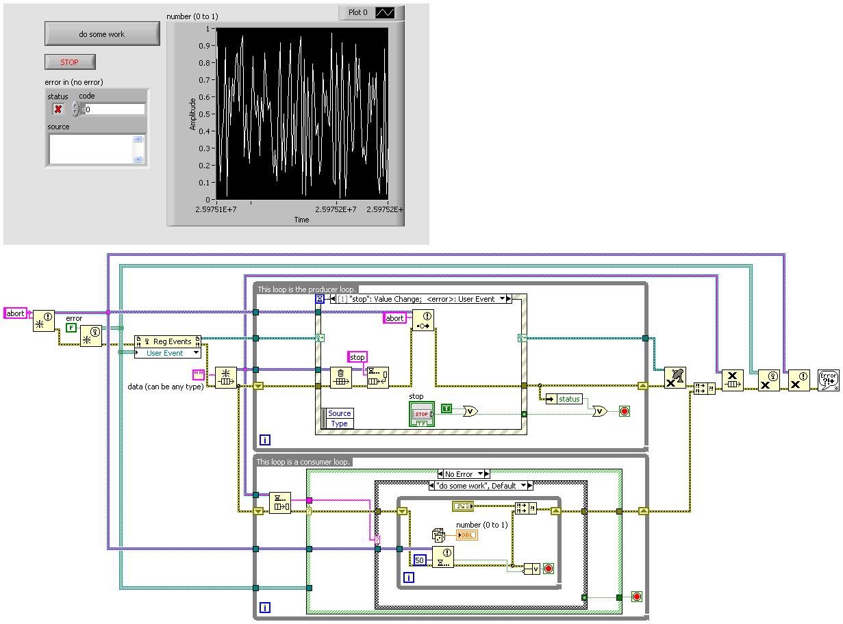

It sounds like you are on the right track.  The concept of an event structure in a parallel loop is a good way to have a system which is responsive to user inputs.
The Producer/Consumer (Events) Design Pattern shows how this can be done.
The problem you may encounter is that your existing code may not be easily modified to accept the Shutdown Now! command.  You hinted at this when you said the main loop sometimes turns things back on.  The event should just send a command to the module which controls the instruments.  Because of the slow response of some of the instruments, the communications with the instruments should not be in the event case.
Without seeing your code, or at least having a good description of the architecture, it is impossible to tell you how you might be abel to make it work.

this vi handles instantly a stop condition by sending out an abort notification to stop a subvi loop, also handles any errors (press status switch during run time to simulate error) by shutting down equipment and generating dynamically a stop to the producer loop...
