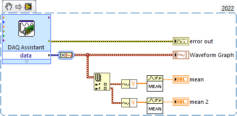

Im using an NI USB 6212 DAQ board to take the input from two strain indicators. I have previously done this with only one and worked perfectly, however, now that I have 2 I run into a problem where when splitting the data from the DAQ assistant it does not work. By does not work I mean that the data being read is plainly wrong. When both strain indicators show a micro strain of 0 the values being displayed on the indicators are not the same when they should be. IMG_3754.jpg

To get you unstuck:
Whenever you don't get expected results, use the debugging features in LabVIEW (such as probes) to find the first place (subVI/primitive/wire) where you have expected inputs but not expected outputs.
In the screenshot you posted, you will find that you do not get expected results when converting the blue wire (dynamic data type = DDT) into the array. Instead, try converting the DDT (blue wire) into an array of waveforms. You can double click the conversion node to configure the type of the output.
You definitely don't get the results you expect from the Index Array primitive. You should not wire the blue wire into the index inputs - in fact, just leave them unwired to get channels from your array of waveforms.   -- Good luck!

Ive encountered another problem, when splitting the data the split array block is not taking waveform data:
(1,184 Views)
It looks like your code converts from dynamic data to a waveform.
Instead, configure the From Dynamic Data to output '1D array of waveforms':
The 'Index Array' does operate on array input.
