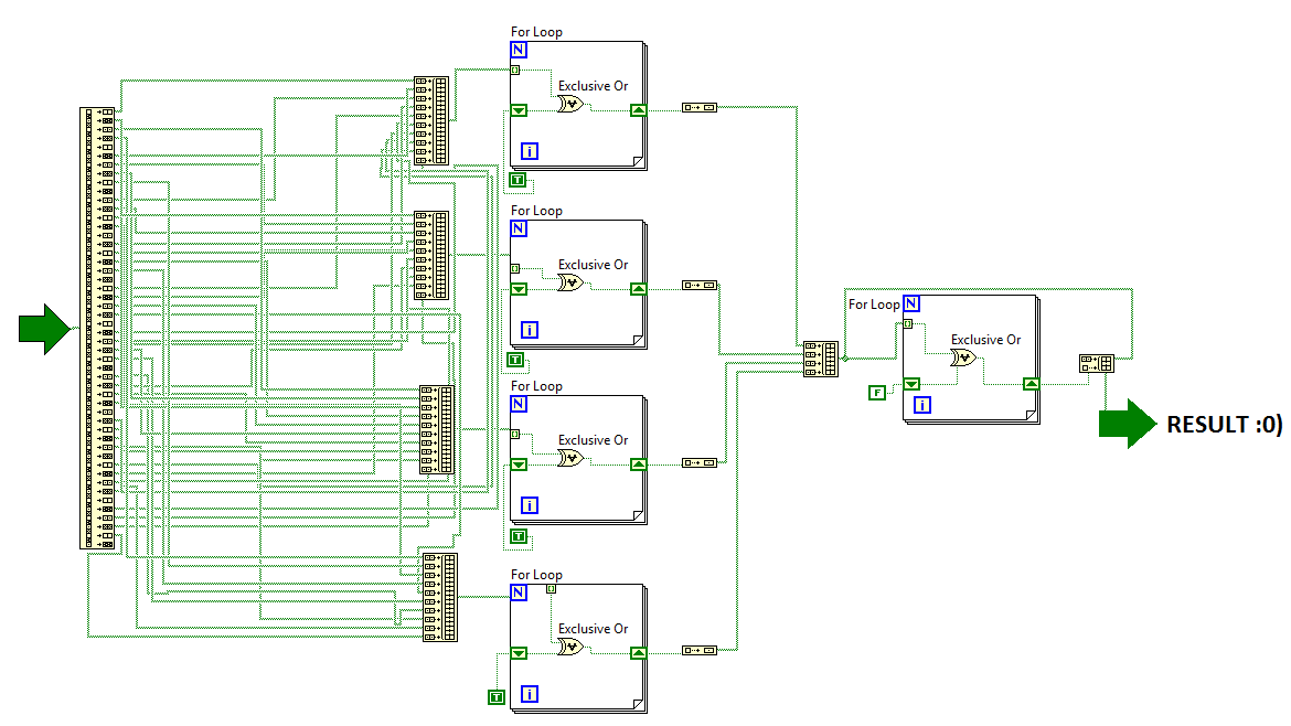

Thanks for the input - Correct the FPGA will not allow for any 2D arrays.  However!
I have used combination from all advice and finally come up with a working solution.  the spec changed slightly as the final parity check is on the parity check of the four colums - not the fifth column.  Its hard to see but I have simply skipped out the every 5th ouput from the decimited arrary of 50.
Please advise if you think my solution is too heavy on resource and if maybe the loop with X-OR is better.  That said for some reason when I use the loop with X-OR the process repeats and gives me different output every other iteration.
please see my solution- i am not saying its the best but its works for now.
Message 13 of 15
(855 Views)
The LabVIEW FPGA compiler, although it has come a long way, does not support For Loops with shift registers yet. Therefore, it is still hard to implement generic algorithms with compile-time inferred (deferred) array sizes. If you can choose the size of the array up front, then you can use the index array and compound arithmetic node to do parity checks.
Depending on the order of the elements in the node, you can change up the indexing or do some decimation and interleaving to get the format in an order you like (all these rearrangement operations are pretty much free on the FPGA).
Message 14 of 15
(849 Views)
I just realized that this post wasn't necessarily talking about an implementation inside a Single-Cycle Loop. If the implementation does not requires the SCL, then a solution with shift registers is perfectly valid. The solution I posted will be properly implemented inside a SCL as well.
Sorry if that confused anyone. And I can no longer edit my original post so here you go.
