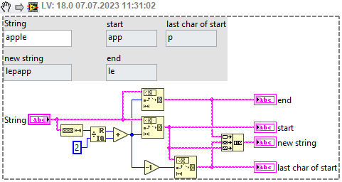

Split a String into two Separate String
Hi so I'm trying to split a string into two halves then put them back together with the second character separating them. For example, if the string is "apple", I want to it to be divided as "app" and "le" then put the back together with "p" in the middle to make "lepapp". I've been trying to use the Search/Split String but I'm not able to get the second half of the string.
I've figure it out with an even number of characters string like "home" to make "meoho" but it's the odd strings that make it confusing to me.

Hi Roni,
You are on the right track using "Search/Split String".
The second half of your string would be the "match + rest of string" output. Also, for odd numbers, since you want to split after the middle character, you could divide the size of the original string by 2 and round up with "Round Toward + Infinity" to compute the split offset.
Raphaël.

See if you can use String Functions; this one uses array functions.

Here is a string version.
Nicely done! But, the decrement is not necessary 😕 delete from array defaults to last value!  Also, the To I32 is ( in this case) better handled as an implied coercion.  Those coercion dots are not always evil!  I actually like the Quotient + Remainder Mod 2 demonstrated by Ulib.
"Should be" isn't "Is" -Jay
Message 5 of 13
(7,013 Views)
I like Ulib Remainder Mod too. Agree about coercion dots, but the OP appeared to be relatively new to LabVEIW so tried to show best practices, which may not be necessary true or needed for all cases.
I am allergic to Delete from Array. 🙂 In this case it does not matter, but it always gives buffer allocations which I don't like.

One more String solution using @UliB quotient remainder
