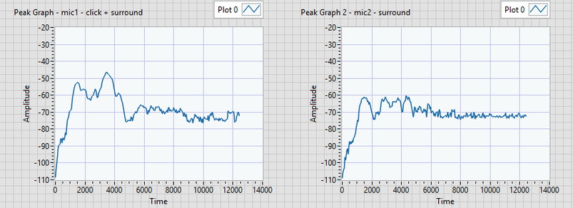

I will go definitely with some better preamp which use op-amp.
But till i waiting components for preamp, i tried to capture some hand clapping with two microphones.
For some reason, mic 2 (which need to capture only surround sounds) and which is directed more to surrounding then mic1, capture weaker surround signal then mic1.
Mic 1 is placed in plastic holder, with almost all sides is protected, so much less surrounding sounds should be captured.
But i got stronger signal on MIC1 from surround sound.
Even sometimes, mic1 pick up surround sounds, and mic2 doesn't, which is very strange.
Both mics have A/D sampling rate 25000. Both are connected on separate differential analog inputs.
Power supply for microphone circuit are separated, on two different analog outputs 2.5V.
Have someone idea what is going on here?
