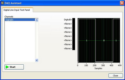

I am using the DAQcard-DIO-24 and a digital output accelerometer for a project, and I can acquire data successfully, but fail to measure the duty cycles which indicate the acceleration. As the input are boolean values, I have tried several methods to convert them into the form that I can measure the duty cycle directly, such as a square wave, but it doesn't work. When I try the "Timing and Transition Measurements.vi", it gives:
Possible reason(s):
Analysis:  The amplitude of the waveform is zero, so the histogram method cannot be used.
I also read the example "Meas Duty Cycle-Buffered-Finite", but it seems the DIO-24 card can only do the soft timing, so it may not be suitable for this application. I am wondering whether there is another way to measure the duty cycle. Can anyone please help me? Thanks a lot.

Thanks for detailed reply. This method is helpful, and based on your suggestion, I am thinking about whether I can use a certain number of samples instead of  time, ie to generate for example 500 samples once using DAQ assistant. But when I select "N samples" acquisition model, the output of DAQ assistant change to 1-D array of digital waveform instead of boolean values. I have tried to convert the digital waveform into an array so that I can use the soft timing method, unsuccessfully. Is it possible to do this?
The reason for this modifiaction is DIO-24 only supports the on demand sample model, where I can not control the sample rate. So probably I can calculate the duty cycle by dividing the number of value 1 sampe from the total sample number of 1 period.

Fortunately I finally get the 1-D waveform converted to a boolean array (as below), but it seems there is only one element in the array instead of 500, which is the sample number of DAQ assistant where I set the acquisition model to "N samples". Can anyone please tell me the problem and how to generate an array with the element number equal to the sample number? Thanks a lot.

You won't be able to do buffered DIO on that DAQCard.  This is probably going to be your best best.  Take a look at the pic I attached.  You will want to go 1 Sample on Demand, and use timing in the loop to control the acquisition.
The reason that you are only getting 1 boolean out is that you are only acquiring 1 piece of data.
