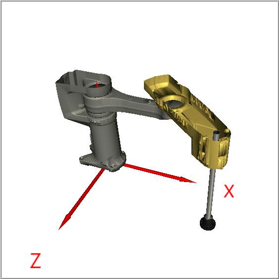

I have an STL file, and loaded the STL file into 3D object. I use Clip Plane option to slice/clip through the object.
But I done get it right way as shown in image.
I also cannot color the plane that I'm clipping.
Initially I was using LabVIEW 2012 later I found that LV2013 had more example, so I downloaded 2016 and working on it now.
Thanks.
(4,606 Views)
I am not sure if you still need help or what you mean by
"I also cannot color the plane that I'm clipping."
Just in case, here is some information:
STL format typically does not contain color information. You might want to use .PLY, .OBJ, or any other format that are used for 3D rendering.
Below is an example taken from here.
Clipped.
Unclipped
Hope it helps.
