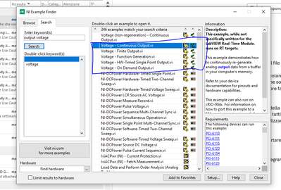

There are a lot of things you can work on. As starting point:
  • Don't use the DAQ Assistant. It is not efficient.You can use it just as starting point. Note: "right-click on the DAQ -> Generate DAQmx code" will create you the code using the DAQmx API.
  • You should improve your "acquisition and generation architecture". Here are some suggestions.
    • You should try to synchronize analog and input tasks (don't know if actually your device support that).
    • Evaluate to read Multiple sample (rather than 1 sample). The same for the output.
    • Have a look on the LabVIEW examples. You should find some useful examples for voltage generation:
(674 Views)
You should use sample clock timing. Refer toSynchronize Correlated Digital Output with Analog Input Using NI-DAQmx and replace the Digital task with Analog Task.
