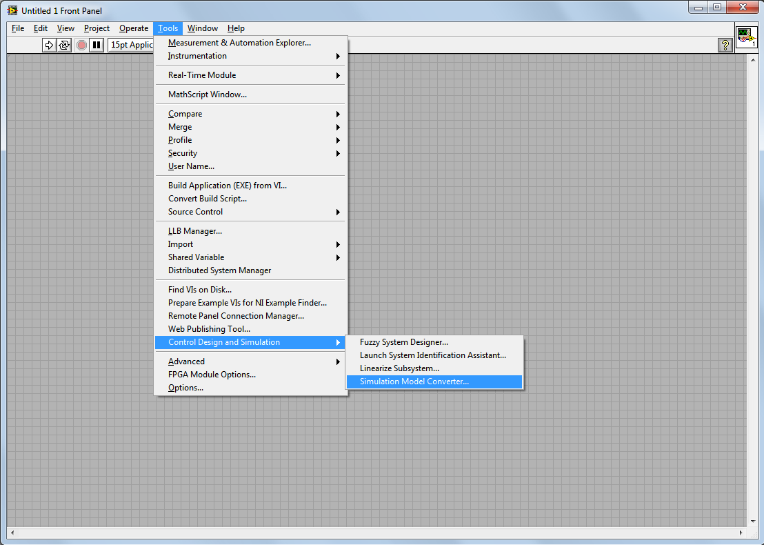

I'm dealing currently with the same task, and i wonder if once you create the .dll that you can call and manipulate, if you can integrate it in a block diagram already done... To be more specific, I am testing different types of controllers, and I only need to convert the simulink models into .vi's that represent the controllers. The rest (read signals, write in memory, etc)all that is already in a block diagram. I don't know if with the SIT conector you can call the .dll with VI blocks.
I'd use the somulation model converter, but it doesn't work pretty well... my .mdl is kind of huge...

If you have Control Design and Simulation Module, you can use the Model Converter to convert your .mdl to LabVIEW VIs.
