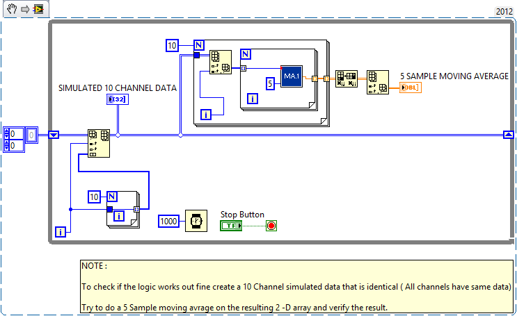

Based on the feedback i got on my original VI i have refined the Moving Average code into a subVI.
I then used it to average a simulated 10Channel data - just to keep things simple i made sure all10 Channels had identical data. One would then expect to get the same moving average for all 10 channels.  I am surprised at the small variance i notice between channels - generally they are close but not exact.
And just to explain the process i am attempting i also have enclsoed a XLS.
So where does the variation come in from ? The unitialized shift register inside the Sub VI ??

Your code still makes no sense. SInce you are calling the subVI one scalar at a time, you are not getting what you want because the shift register only rememebers the last N scalars, no matter what channel it is from. Your code is still very inefficient and convoluted. (e.g. why are you still using insert into array to append (both in the mani nad in the sub). (You could use a reenetrant subVI and a parallel innermost FOR loop, but that seems overly complicated too)
If you want to do a running average on each channel, the subVI needs to keep a 2D array in the subVI. All this has been done before.
