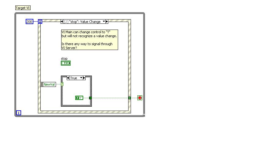

I have a sub-vi with an event structure which is being called from a main vi through Call by Reference. I can change the values of the controls on the sub-vi but the sun-vi does not recognize the Value Change in the event structure. Is there any way to send a value change signal to the sub-vi from the main vi? My goal is to not have to make changed to the sub-vi. I have attached a pseudo-example to show you what I am trying to accomplish:
This is the main vi with a call by ref to the target vi
This is the target vi. A Value Change is not recognized when the control value is changed from Main vi. Is there any way to do this?

You need to use the Value (Signaling) property on the control reference.
One way to get the control reference is to get the Panel property of the VI reference, then the Controls[] Property of the panel. Then loop through the controls looking for one with the proper name.
(4,120 Views)
I knew Value(signal) would work but I didn't know how or if it was even possible to get to the reference. Getting the control references from VI refnum did the trick. Thanks.
