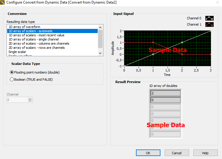

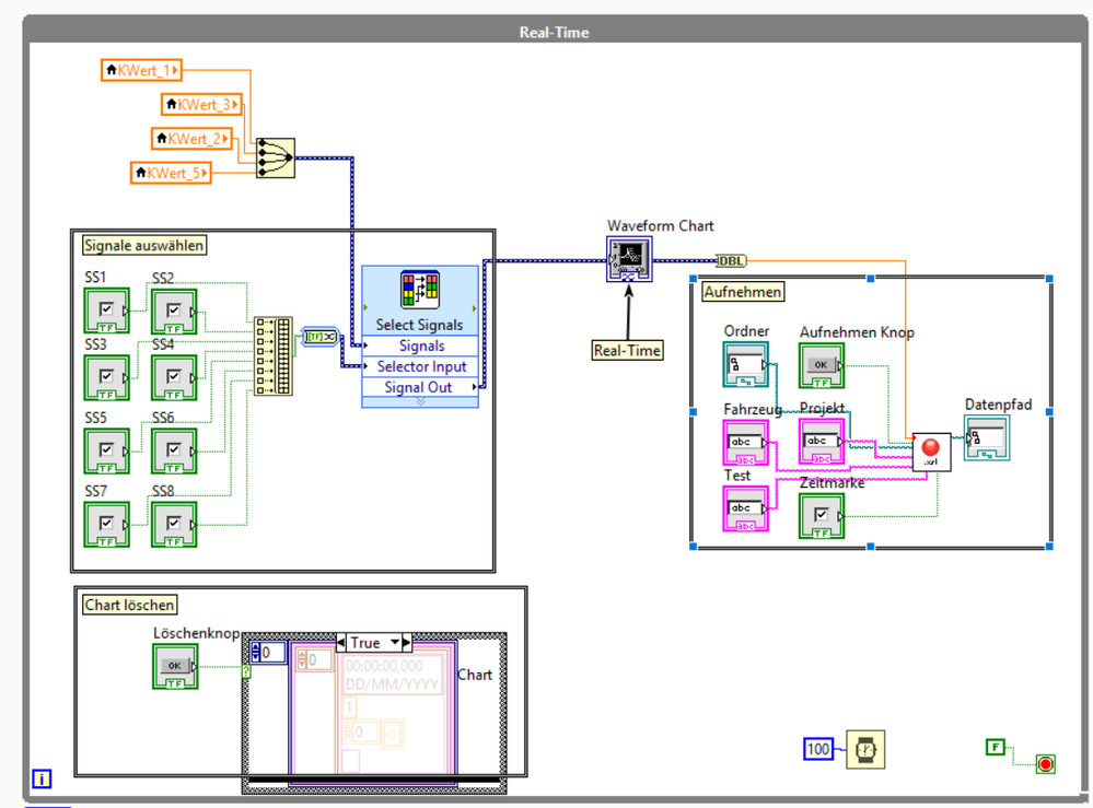

I made a signal selector so I can choose how many I want to show. In order to use the signal selector I convert my input signals into dynamic data. Just after the selector I convert it again to Double data to record it using a subVI of mine.Captura.PNG
Unfortunately, it doesn't work. I am sure I made some mistakes but I cannot find how can I make it work. I would be very gratefull if anybody can show me what mistakes did I made.

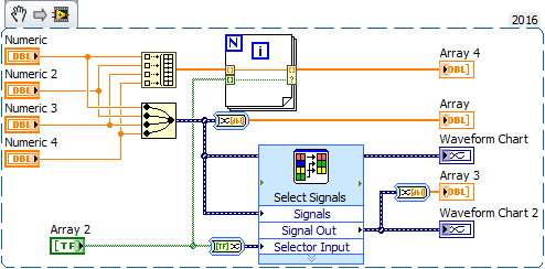

check converter settings
but better use simple methods (upper for loop with conditional autoindexing)

Hi Chief,
@chiefautomation wrote:
Can you tell me how you created the check box for each signal and how it goes to the input.
Can you send me a copy of you example.
In your own example you create an array of booleans -  in the example you got there also is an array of booleans!
When you don't know how to create such an array control then you should (re)take those "Training resources" offered in the header of the LabVIEW board to learn the LabVIEW basics…
You don't need "a copy of the example" as you got a snippet in the previous messages. Read the LabVIEW help to learn about using snippets…
