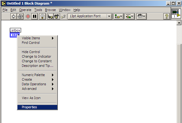

It already exists and is called "Tip Strip"  😉
To edit the Tip Strip for a control (or indicator or object) right click >> Properties >> Documentation >> Tip Strip
You can also do it programatically using a property node like this :

it doesnt work in my userinterface....
iam new user..
so can u tell me briefly step by step procedure...
when i right click my listbox it displays "GENERATE CALLBACK,VIEW CALLBACK,CONTROL HELP,EDIT CONTROL"
there is no properties as u told ..
wainting for ur reply..

Smiley Surprised
Do you not see this on the diagram when right clicking on the listbox ?
Anyway, you can also do it from the front panel. I forgot to say that when the VI is not running, you have to select the "finger tool" and place it over the listbox to see the tip strip ; you wont see anything if you have the linking tool for instance. 😉
