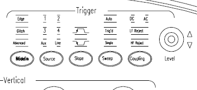

I have an older model Infinium and I don't have that button. The service manual for the 54845A doesn't show it either (see bleow) and of course Agilent no longer has the user manual on line because it's obsolete.Smiley Mad
If you do have the user manual, you might want to check to see what the button does. If the driver doesn't contain the function, it's just possible is was missed by the programmer who wrote the driver. There might actually be a command that you can send but the first step is to determine what the button does exactly and I'm afraid I can't help much unless you have an electronic copy of the user manual that you can post.

My apologies. I am actually using the 54854A Infiniium. Bit of a typo. I should have double checked that before I posted!
I think I have figured it out anyway. The sensitivity setting has to do with hysteresis. A low sensitivity adds hysteresis to the trigger circuit, while high sensitivty lowers it so that you can trigger on higher frequency waveforms.
The conf trigger.vi has a hysteresis control that allows you to set 'Normal' or 'Noise reject'... turns out that normal = low sensitivty and nose reject = high sensitivity
Just a bit confusing with the different terminology.
