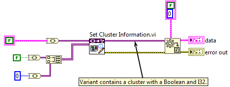

The 'Set' VIs in the Data Type Parsing API are not officially supported mainly because they solve an incredibly rare use case, which is creating or modifying arbitrary data types without preserving value. Here is an example usage of the Set Cluster Information VI:
In order for the VI to work correctly, the input has to be a variant containing a cluster. If you are wanting to define a new cluster type, then the elements of the source cluster don't matter, but it does have to be a cluster. In the code above, the VI creates a variant containing the cluster data type, and the Variant To Data will execute without error.
(4,153 Views)

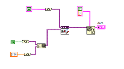

Excellent timing, I am trying to use this VI, but it doesn't appear to work. I run this VI and the output "data" is still just the default data from the cluster.
(4,137 Views)
As I mentioned in my previous reply, the Data Type Parsing VIs do not preserve value when reading or writing data type information.
(4,133 Views)
Hence, "Cluster Information", I definitely didn't read your reply properly. Thanks!
