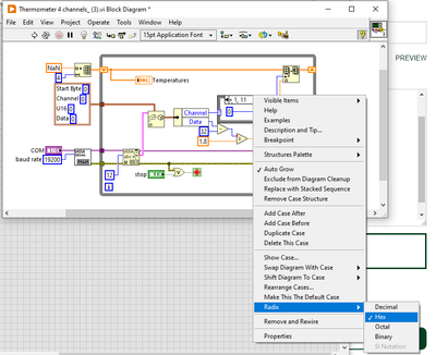

4.  I would do something like this.  The idea is to store you temperatures in an array and you just update the value you just received.  Notice I reduced the read size to only cover one temperature at a time.  But the powerful part is the Unflatten From String to parse the message for me.  The cluster contains an U8 for the Start Byte, U8 for the Channel, a U16 for I don't know what they are for, and finally a U16 for the data.  After that, it is just doing the math you already defined for the data and using the case structure to decide which element in the array I am replacing.

Hi Crossrulz, Mr.Altenbach, Gerdw
Can one of you please explain to me the 1,11 / 2,12/ etc... part of the case structure? I just want to expand my knowledge.
2nd question) Does the case structure's radix should always be changed based on the type of data being read?
I look forward to hearing from anyone who understands this.
Message 20 of 34
