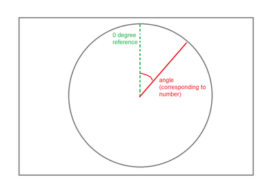

I was also wondering, would it be possible to create some kind of radar looking GUI to draw a radius at an angle corresponding to the number I received via serial? (Picture of what I am after is in the attachments.) Since I am complete beginner to labview, I also wanted to ask an advice how do you create something from zero when you dont have a clue on how to do it?

there are several wasy to achieve the diagram you're asking.
You can plot a compass plot (right click on front pannel, select graph -> compass plot.
There you have to wire an array for the radius and the angle (theta). Wire the signal you read from serial (after converting string to double ) and it will plot for you.
