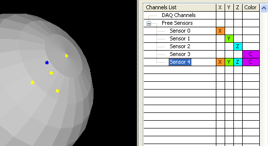

Three columns: X, Y, and X. I can't find any documentation as to what they do. Any Ides?
I ask because I am attempting to generalize the Sensor Mapping helper such that I can pass the helper x, y, z, and intensity data for an arbitrary number of sensors onto a sphere. Thanks.

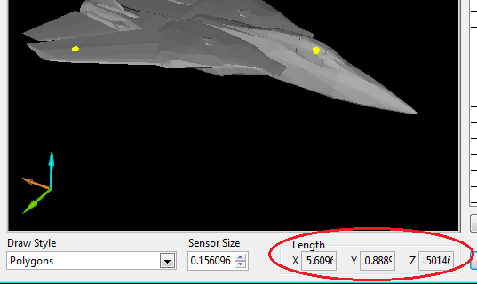

Is this the X Y and Z that you are talking about:
22831i9E1C1ECE3943D325
This is related to the size of the model.

Thanks for responding. However, that is not the X,Y, and Z I am talking about.
The ones I am interested in seem to be connected to the sensor inputs. Just like the pink "C," I can get the X,Y, and Z column to highlight. I can also get the model to move on one axis using the sensor input, but not along the other two.

I think it is the actual position of the sensor. Previously, it never told you the absolute position, so you could only 'eyeball it'.
Good to see it is in there. I was thinking that such a feature would be useful under 2009 in a project.

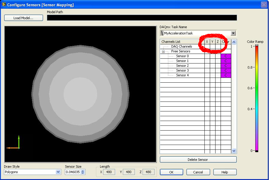

Possibly, however the only information these boxes display are indication of an IO state.
23158iA4549CC54F62EBE8
Although if you hover your mouse over a sensor it will give you the position in X,Y,Z.
