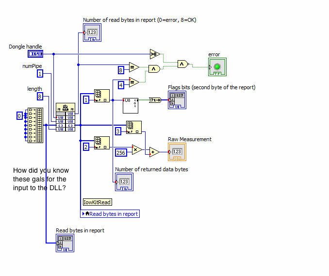

Here is a question for the EKP-3 using the USB for the SDP6xx Here is an overview of what I am looking for...
http://www.screencast.com/t/RUDOisSvqC
I have the Sensirion EK-P3 Stick to talk to the pressure transducer..
This stick is made by these guys: http://www.codemercs.com/349/

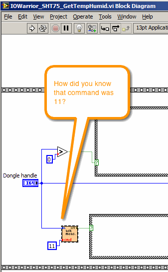

My question is how did you figure out the binary code to read the T and RH from the  iowkit.dll
I want to read the RAW TICKS from the device that represent pressure. They go from 0 - 65535 and I have spied on it with WireShark and can not wrangle the binary code to read the raw ticks I am after.

Raw Ticks refer to the actual raw signal given by the Sensirion. It uses a 0 - 65535  (16 bit) output for +/- 0-5 InH2O (Or whatever the range is) So 32,767 is nominally 0 (ZERO) and 0 is nominally - 5 inH2O and 65,535 is nominally 5 inH2O.

Cameron... Wondering if you knnow how to get a 2's compliment for a 12 bit value in LabVIEW?
I am looking to get the code to communicate to this top secret Sensirion product.
Anyone know if I am properly sending the commands at 1, 2 and 3 of the image below?
At issue, I think, is getting the two's compliment of the two 8 bit registers at Data LSB and Data MSB using LabVIEW...
I have been working with the wizards at http://www.codemercs.com/258/?L=1 who have been EXTREMELY helpful.
They have an AWESOME I2C to USB converter that you can get OEM devices to work for your I2C project. It is a single channel version of the NI-8451
Anyone out there can figure this out so I can read the RAW TICKS from the Sensirion SDP6xx product line?

I am still working with this silly thing! Can anyone figure out how this thing works> The datasheets and sample code are not clear.
All I am looking for are the few hex values to do the following:
1) Set up the measurement as shown in the 1 in the graphic.
2) Send the correct value to read the desired variable as shown in 2 in the graphic.
3) How to cipher the output.. I want the full 16 bits...
See this video....
http://www.screencast.com/t/VWFYx7mc
See if you can figure out this crazy thing! I am sure I am missing something VERY SIMPLE!
In the end I really only need to know the right values to put in the graphic below...
What am I missing??

I apologize for taking so long to respond to this forum, but I am a bit confused as to what you are looking for.  Do you want to ascertain the two's complement of a 12 bit or 16 bit number on the output?  Doing this with a 16 bit unsigned interger should be fairly staight forward.  Does this VI help at all?
