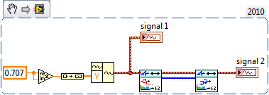

Dear you are not getting my point; there is nothing wrong with modulation scheme the problem is in discrete wavelet transforms!!!! Please read the question, I am having problems in reconstruction the signal back, specifically saying QAM but the problem is almost same with every modulation scheme

I'm not sure if I completely understand your question.
So you are inputing a QMA signal into the "inverse discrete wavelet transform.vi" and then passing this into "discrete wavelet transform.vi"?
And you are only getting the real part back but are expecting both a real and imaginary part, correct?

ya exactly but input to a "inverse discrete wavelet transform"  and one more thing how to give delay(Z^-n) in labview ??

Hi Ahsan,
I created a small VI that replicates the issue you've described.  You can see the coercion dot on the Discrete Wavelet Transform VI - it is being converted there from a complex waveform data type to just a waveform (the imaginary part is being dropped).  This would indicate that the VI does not accept complex waveforms, but I'm not sure what the best workaround would be.  Can you confirm that this is the problem you're seeing as well?  Also, can you give some more detail about the delay you mentioned?

  • thanks a lot, i appreciate your effort, i have sent you a doc file to give you an idea of how it looks.
idwt/dwt does except complex symbol but drops the imaginary part by default. if you try to separate the both or try what i did than still useless.
have a look and than tell me
