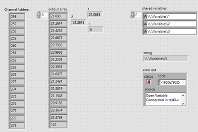

I am connecting to my hardware via network and using modbus to read the data. I have a series of channel addresses (not consequtive) in an array which I then loop through, read the modbus registers and format the data. This data is stored in a further array (A) . I have a listing of the shared variables also in an array (B) and want to write the corresponding value of A into variable B. This is my problem, try as I might, I cannot get the writing of data to work.
The orange line is the connection to the data array (A). For test purposes, there are 3 shared variable with the names "1", "2" and "3". When I get the write to work I will supply a listing of the shared variables in an array.
Labview 2019, 32 Bit with DSC module.
The error says that a connection on open variable is missing or wrong.

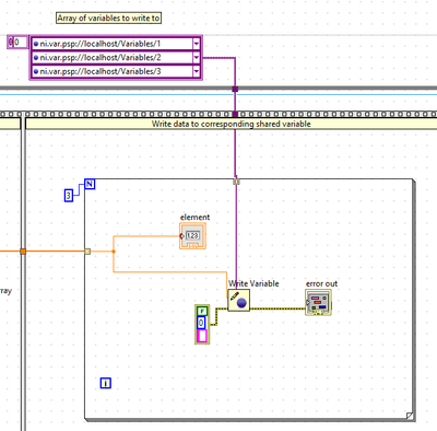

  1. Why don't you wire the SV reference directly to the OpenSharedVariable function? Why do you need the URL string in between?
  2. You forgot to wire the reference output of the Open function to the Write function…
(2,492 Views)
It will not accept the SV reference to the OpenSharedVariable function. The data line shows Network Variable (BV Tag) and the input is a refnum.
"You forgot to wire the reference output of the Open function to the Write function…" - corrected, thanks.
(2,482 Views)
After making these changes, the VI will run but the shared variables are not updated.
And I have this error:
(2,460 Views)
After sleeping on the problem, I have found the error and solution. The problem was the variable Refnum. A small demo VI is below. The Shared Variables MUST be created first.
Right click on the network variable (on the right) and changing to programmatic access gave me the correct Refnum string. This I copied to the left side and wired to the write function. This demo runs too fast to be able to see the data change!

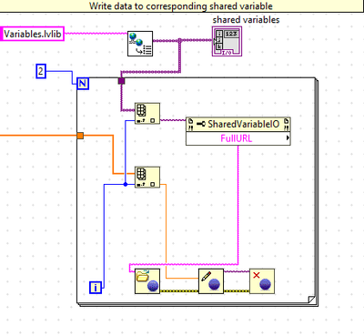

In my original VI I then created an array with the Refnums and wired it to the Write function WITH autoindexing. The data array I also set to autoindexing. This runs fine in about 250 ms for the whole VI - fast enough for me. The end result is below.
